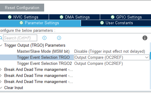

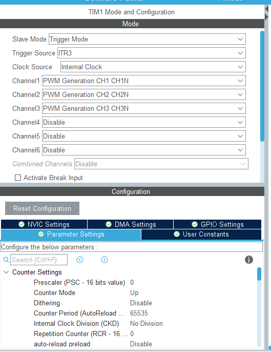

I am trying to use combined channel :XOR/HALL sensor on timer 4:
and trigger mode on timer 1 to trigger pwm:
I don't understand why my trigger is not working.I see a constant pwm on the line

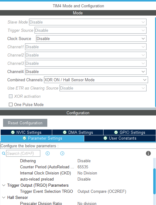

The first picture gives the impression that timer 4 is not enabled.
You cannot trust CubeMX 100%, it's mostly a starting point, so always find a way to check the register settings (UART).
2021-11-22 1:08 AM
I am using STM32G431CB, which has dedicated pins for hall sensor.So when ever i select XOR/HALL sensor setting.The channel assignment is done automatically and so i cannot change any settings.
2021-11-22 7:05 AM
I believe LCE is saying that "Clock source: Disable" indicates the timer isn't running. Probably this should be set to internal.
