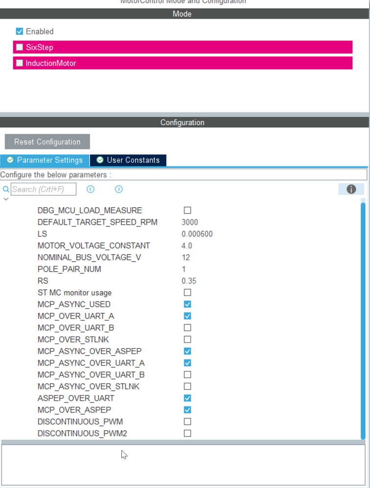

I am running on a STM32G071 board, with my own custom HW (standard 3 phase halfbridge). The control is FOC sensorless with 1 shunt
I am having problems tuning the motor, but for starters I would like to run the motor at low speed in open loop
I can find a parameter in the IOC file name Open_Loop_FOC which I can set to "true"
But how do I set the operating conditions and how do I start the motor in Open loop mode?

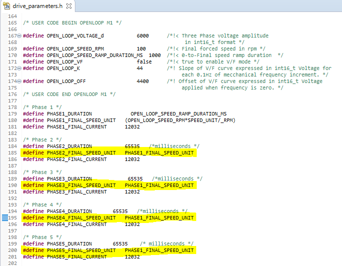

I think you have this issue due to the use of an old version of the MC Workbench.
The issue is in drive_parameters.h, be sure to have these declarations:

When I change the Open_Loop_FOC to "true", I get compile time errors:
mc_config.c:135:67: error: 'PHASE2_FINAL_SPEED_UNIT' undeclared here (not in a function); did you mean 'PHASE1_FINAL_SPEED_UNIT'?
{(uint16_t)PHASE2_DURATION,(int16_t)(PHASE2_FINAL_SPEED_UNIT),(int16_t)PHASE2_FINAL_CURRENT,&RevUpControlM1.ParamsData[2]},
mc_config.c:136:67: error: 'PHASE3_FINAL_SPEED_UNIT' undeclared here (not in a function); did you mean 'PHASE2_FINAL_SPEED_UNIT'?
{(uint16_t)PHASE3_DURATION,(int16_t)(PHASE3_FINAL_SPEED_UNIT),(int16_t)PHASE3_FINAL_CURRENT,&RevUpControlM1.ParamsData[3]},
mc_config.c:137:67: error: 'PHASE4_FINAL_SPEED_UNIT' undeclared here (not in a function); did you mean 'PHASE3_FINAL_SPEED_UNIT'?
{(uint16_t)PHASE4_DURATION,(int16_t)(PHASE4_FINAL_SPEED_UNIT),(int16_t)PHASE4_FINAL_CURRENT,&RevUpControlM1.ParamsData[4]},
Any hint to how to avoid those?

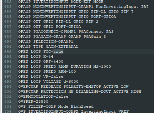

Looking for this OPEN_LOOP_FOC, but not finding it. Runing 5.y.4
2022-07-20 2:20 AM
you need to open the .ioc file in editor and search for OPEN_LOOP_FOC
2022-07-20 9:08 AM
Thank you! I did find this and have it functioning. Curious why this isn't in the gui?
