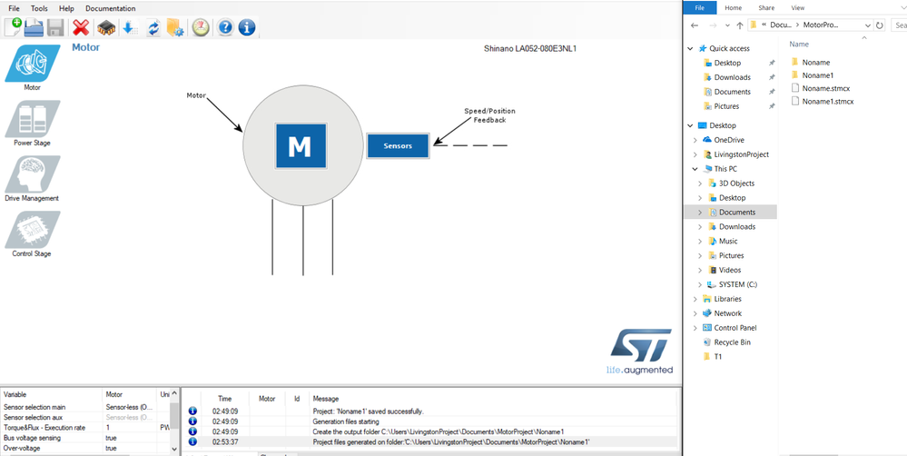

I have a project to control a BLDC sensored motor. I am not sure how to move forward. I have AC6, IAR and MKD installed. I have tried installed motor control workbench with no luck. X-CUBE-MCSDK executable that can be downloaded from the following link does not work for some reason.

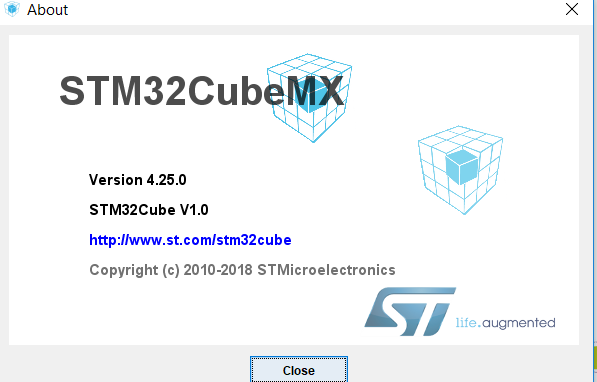

FIY, I am using Windows10 and I have STM32CubeMX installed.

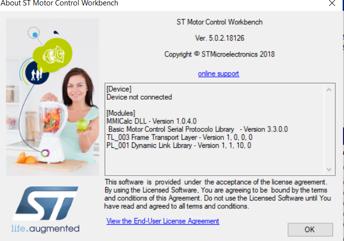

Could you me please let me know if code generation is successfully working ? I am fed of trying to generate code, but I having some problems in generating the code. (with mcsdk 5.0.2 or 5.0.3)

I think I managed to generate the STM32CubeMX project. I can't test this with my motor as the motor control program does not include the STM32F401RE board, which what ST recommends for the NUCLEO-IHM08M1 shield. The project does open using STM32CubeMX. I already tried to compile ''as-is'' with IAR and failed. I am going to try make it work without the motor control workbench software.

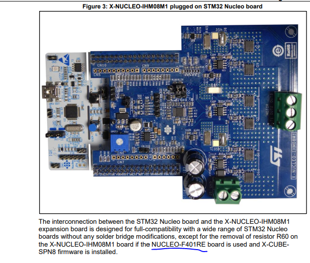

The 6 steps software solution for IHM08 can be downloaded here :
It supports the IHM08+STM32F401RE or IHM08+STM32F302R8.
The FOC software solution (
X-CUBE-MCSDK ) does not support the
STM32F401RE in the 5.0.3 version. It was not supported in the 4.3 version too.
We plan to add the support of the STM32F401RE in X-CUBE-MCSDK 5.1 version.

The boards that I have currently are the STM32F401RE and STM32F446RE. I bought the F401 specially for the
IHM08M1
shield, but it's not listed in the ST motor control workbench software.I am looking into the code you provided in the link. There is a similar one for the SPIN3202. What I am trying to do right now, is to understand the code so I can start manually editing it. I knew I had to do this eventually, but I just thought there might be an ''out of the box'' solution, that is temporary until I make improvements myself. I sort of got motor spin one rotation, but I think it's designed for motors with RPM > 2000, so I need to fix that.
