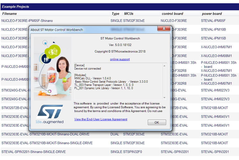

I'm attempting to generate project code for the STEVAL-SPIN3202.
ST32CubeMX doesn't have an option for the
STEVAL-SPIN3202 so I tried using the ST Motor Control Workbench and it gives an error 'STSPIN mcu not supported in the FW for SDK5'.
Meanwhile, I'm using the example project provided in 'STSW-SPIN3202'.

Since the
STEVAL-SPIN3202 isn't supported by the current STMCWB 5.0, I abandoned it and switched to a board combination that is supported: a NUCLEO-F302R8 and X-NUCLEO-IHM08M1 motor controller board.

Vitaliy-
Good point but I still got the
error '
STSPIN mcu not supported in the FW for SDK5'. I'll try opening that SPIN3201 project and try it with the SPIN3202. I'll post a question asking what the difference is between a 3201 and 3202.

Dear Jim,
STEVAL-SPIN3202,
STEVAL-SPIN3201 will be back in the 5.1 release scheduled for end of May.
As the SPIN32F0 is based on a STM32F03 MCU, you can already generate the code with the 5.0.3 release but it is not so straightforward.
