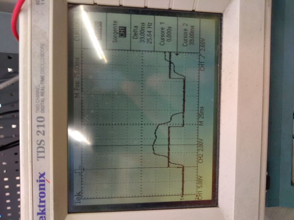

Is this somehow meaningful? Showing U and U hall sensor

I could also confirm that the Hall sensor states change every 1/3 of the current hall period, then the physical displacement should be 60°!

I’m not sure I got this last sentence: if there is a change each 1/3 of a period, then I expect a 120° displacement.

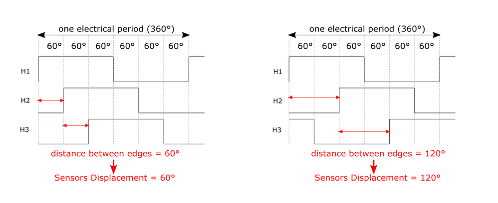

To make it more clear, I made a diagram about the digital Hall sensors:
As you can see the sequence of the Hall sensors is always divided in “slices�? of 60° each.
But it is the phase between signal edges that makes the difference.
The combination the sensors’ digital levels is different each 60° in both cases.
It’s enough to measure two Hall sensors and see which is the displacement about your motor.
Then select the correct configuration in the workbench. Let me know the result !
