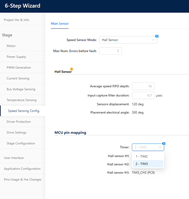

Hi All, one of the changes made into the new MCSDK WB 6.4.0, is the ability to choose the timer number used to catch the HALL inputs
By default, the timer selected is the Timer 2, that could be different of the one used into MCSDK WB 6.3.2.

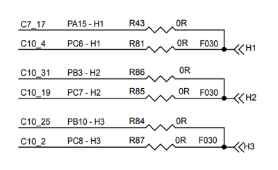

Naturally, another timer choice will generate different PINs for the H1, H2 and H3 signals, and in consequence a problem of connection if boards have been modified in desoldering access to the unused HALL signal connections for example.
MCSDK WB 6.4.0 HALL timer setection
i.e IHM16M1 HALL possible connections

I checked and that's not the issue for me. In either my custom board or IHM08M1 the Hall inputs can only be connected to a timer so there is no choice.

Hi jovijuan, thank you for your post, we identify the problem, and a correction will be applied into the next version of the MCSDK.
Unfortunately, the configuration for the Placement electrical angle parameter HALL_PHASE_SHIFT has been set up for a specific HALL sensor (300 degrees). Besides, this parameter is not extract from the configuration defined into the MCSDK WB tool (stage motor).
