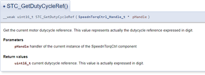

I'm using 6 Step Motor Control and wonder what's the unit of the returned value from STC_GetDutyCycleRef() in speed_ctrl.c?
I set the reference speed to 1000rpm. After I started running a motor, I saw the returned value from STC_GetDutyCycleRef(), ramping up to 3200 from 0.
I would expect the returned value from STC_GetDutyCycleRef() to be 0 - 100 (%).
What's the unit of the returned value from STC_GetDutyCycleRef() ?
