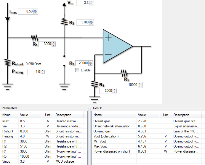

Results: click 'run motor', little jolt of the motor and "Over current" failure

I will try to bump this topic as I did not moved any further with this issue. I have no idea how to make this board working, the MOSFETS are OK, I cannot find any info about using this board anywhere.
Can anybody help me with that?

@KSzul.1 did you find any solution? I have similar problem, I just get a ding when I press start/stop button and this is it.
