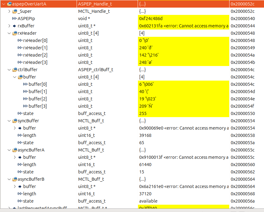

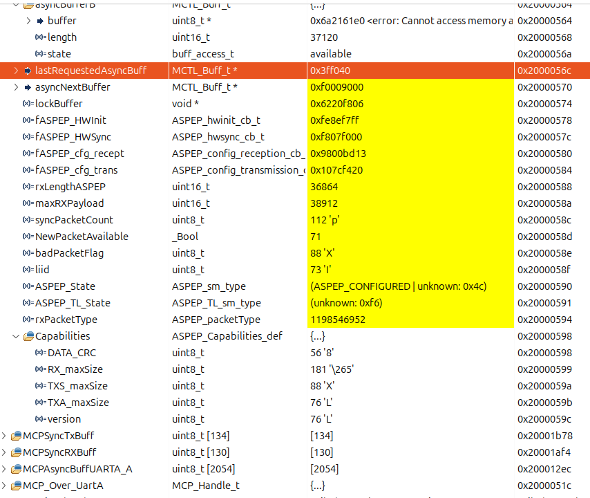

  4. I reset the processor with a button press and observe the aspepOverUartA.rxHeader[0-4] is not filled with zero's like it was after debug downloading.  Instead it contains "0x00 0xF0 0x8E 0xF8".  Every reset of the processor results in this value being in the registers.  I power cycled the board, debugged without downloading, and the values were still the same. Other register values on reset.  There's a lot of registers that say "can't access memory"
    1. Screenshot from 2024-10-10 17-39-48.pngScreenshot from 2024-10-10 17-39-19.png
