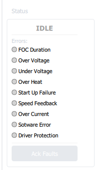

Please report the error that is eventually shown in the panel below.
If you feel a post has answered your question, please click "Accept as Solution"

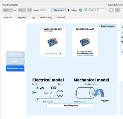

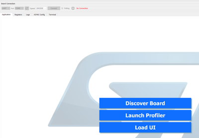

The Motor Profile tool will not connect to the debugger
But the Motor Profile tool connects right away:
But either way I don't want to run the motor through the Pilot program, I just want the firmware to boot up and spin the motor when I press the button. This currently takes me to successfully run the motor profiler in order to have the button work.  I've also tried a basic ramp command from boot and the motor makes a slight buzz before doing nothing:
