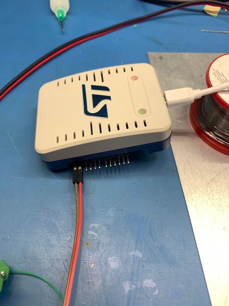

So i have two Kit Robot and the second i want to use it in speed mode. I generated the binary with parameter "speed" and i put in second board but i can't connect and check it with MCworkbench. I set a baudarate to 9600 and change the connections like in image.

If you want to bypass the RS485 transceiver and use the STLINK-V3 VirtualCOM instead, you need to check the following:

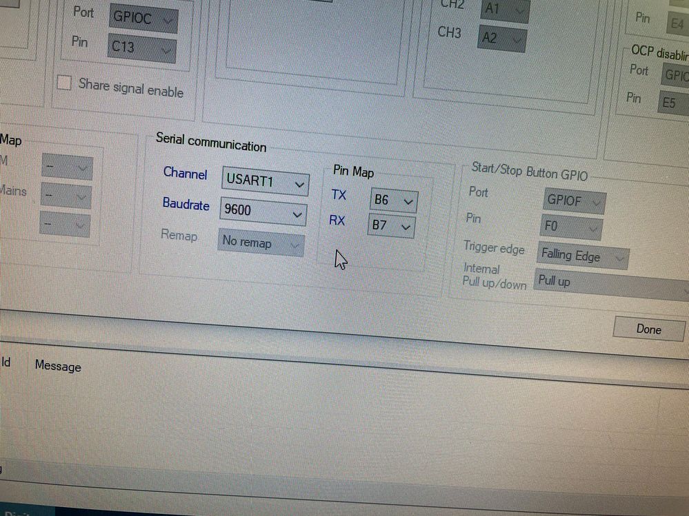

  • UART is properly configured in the MCWB: TX/RX mapped on PB6/PB7 and baudrate 9600
  • STR485 disabled or unmounted (I see from your pic you removed it, please check no shorts are present)
  • STLINK-V3 connection (hardware board MB1440): CN3 RX pin connected to TP13 and TC pin connected to TP14. Please note that labels on the CN3 connector could be misleading. As indicated in page 25 of the UM, TX/RX labels refer to the target not the STLINK itself.
  • Connect the ground of the EVALKIT-ROBOT-1 board (TP18 or any other ground connector) to the STLINK-V3 (e.g. CN4 pin 3)
  • Keep the connection cables as short as possible in order to avoid noise

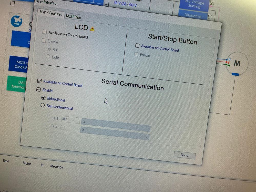

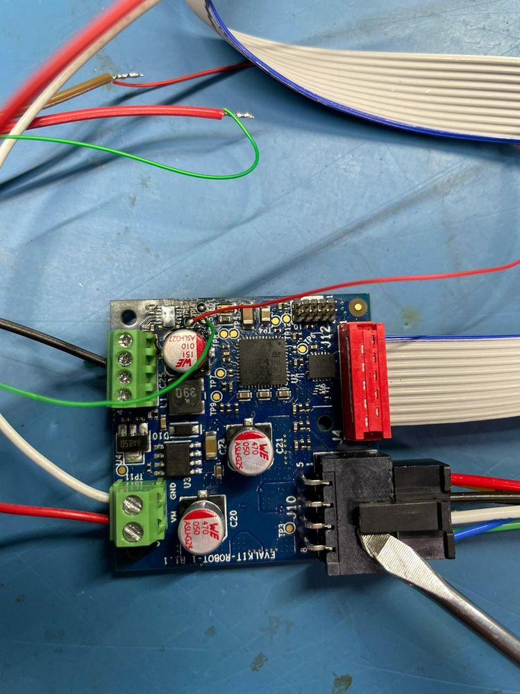

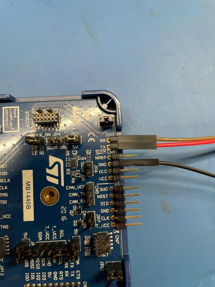

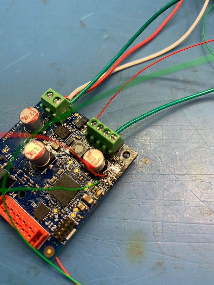

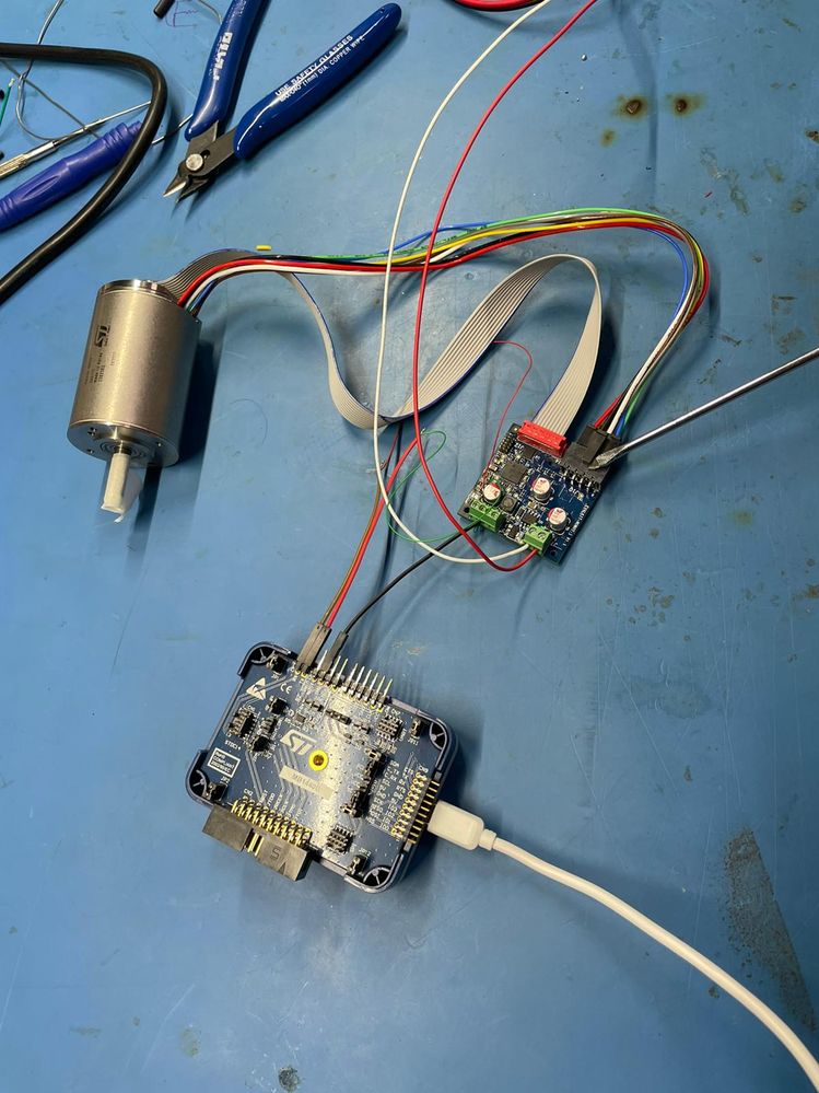

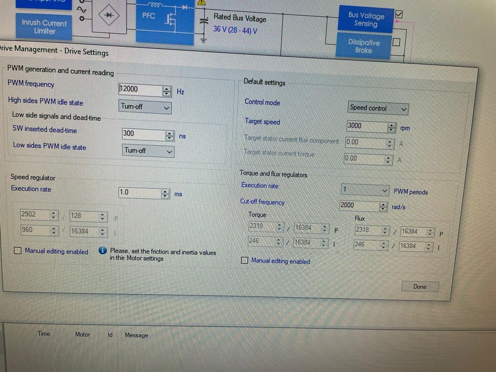

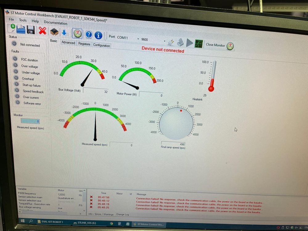

i followed your check point, but device doesn't connect with MCWB. My connection and parameter setted on MCWB:

Enrico Poli

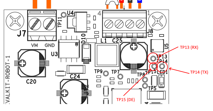

I notice only now that you connected the TX line to wrong test point, sorry for that.
TX is on TP14, but you connected it on TP15:
0693W000008wMXoQAM.pngLet me know if this solve your issue
DBrag.1
Associate II
Perfect! It working : )
