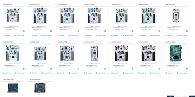

Could you tell me if you use your MCU with an ST board, or your own board ?
The strategy is now to describe your board based on json description.
For STM32F407 series, we support STM32F407IGHx and STM32F407IGTx, so if your control board referred to one of them, it will be supported. The easiest way to describe your board is to use the board manager starting by cloning the closest ST board.

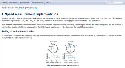

The phase sequence coming from your motor's maker illustrates 6-steps algorithm.
I guess the algorithm configured with the MCSDK 5.4.8 is the FOC. As it is vectoriel control the phases will change at PWM frequency not at 60 electrical degrees.
From what I can see, I advise you to connect the black wire to H1, the grey wire to H2, the blue wire to H3.
Doing so it will be aligned with the Hall sensors description configured at 120 degrees.
Be aware that another parameter is important to tune for having a working Hall sensor configuration, the "Placement electrical angle", both parameters are available in the motor configuration window.
I would advise you to give a try to MCSDK 6.2.1. We propose with the motor profiler a way to profile your Hall sensors if you generate your profiler project with Hall sensors as auxiliary sensors.
And of course, I invite you to read the documentation coming with the MCSDK, and particularly the topic "Hall sensor feedback processing"

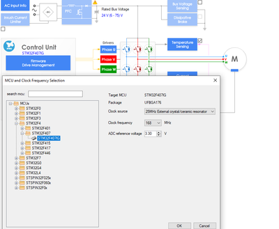

and I tried to run the new MCSDK version but I couldn't find the controller I'm using in the control section,
as I'm using the STM32F407 controller with EVALSTDRIVE101
in the older SDK version 5.4.8, I can find the controller but not in the newer version
thank you in advance.
