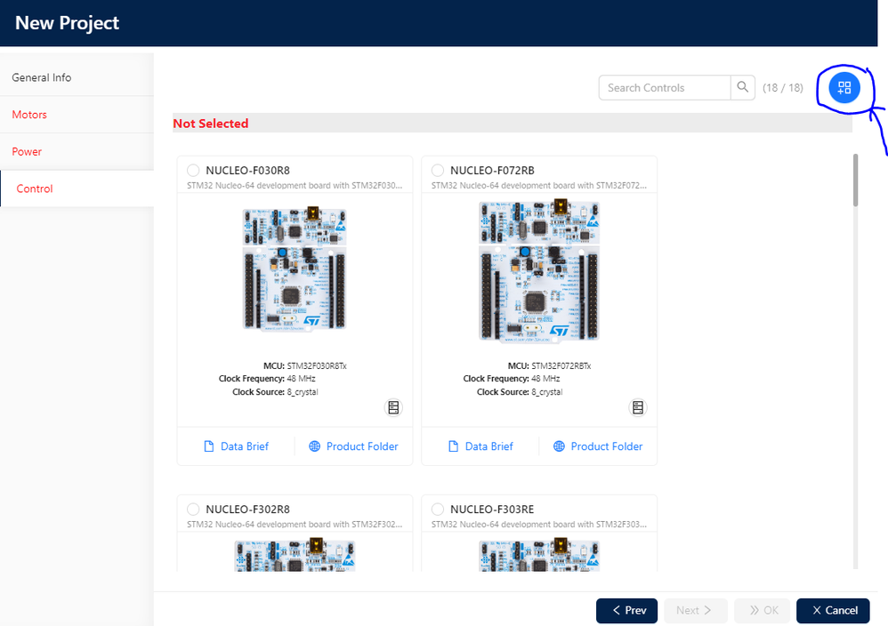

I want to use NUCLEO-G491RE with MCSDK6.1.2. However, NUCLEO-G491RE does not exist in the list of "Control" of MCSDK. If I have a NUCLEO-G491RE JSON file, can I import it? Where can I get the JSON file?

unfortunately this board is not currently supported by the MCSDK. You can add your board by clicking on this button:add_board.PNGDocumentation will be available very soon to help you describe your board.

I see. It means that there is no NUCLEO-G491RE JSON file anywhere now.I will try to make it as you told me.
