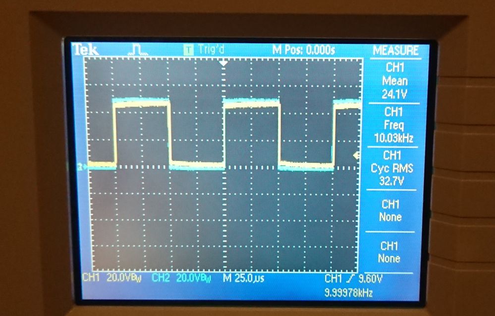

I'm using motor control hardware very close to NUCLEO-G431RB with X-NUCLEO-IHM08M1 3Sh. It has only a bit different bus voltage and current feedback scaling resistors so I was able to spin the motor it with the motor profiler. The results were quite close as measured, RS=0.1 ohm and LS=0.08 mH. So I know that the hardware works.
Now when I configure the parameters in the MC Suite, it results in around 50% constant PWM phase output, exactly same for all U, V and W channels. Which obviously does not make any sense.. At the end there's an oscilloscope picture of U and V running at 10 kHz. Same figure is acquired with 30kHz too.
If I raise the inductance value closer to 1 mH, the PWM starts to get correct shape, but this is too big of an inductance value to make the motor spin, it just does not work. I tried to chase the possible bug/problem/issue where the PWM is configured according to the parameters derived from LS, but this seems to end up in the libmc closed library...

Answering to myself: there was no problem relating to the low inductance. I didn't mention, but the motor is pretty big (rated to 3kW) so I totally underestimated the required rev-up currents. After reconfiguring the startup conditions with MC SDK, the motor started spinning just fine!
By the way, now when the basic setup works for the motor, the on-the-fly motor startup and speed ramps work like a charm. I'd say that the MC SDK makes BLDC motor control pretty easy when the hardware is close to the evaluation boards.
