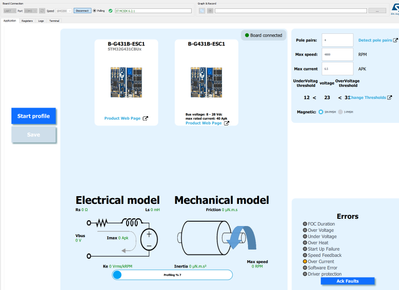

However, whether I'm using MotorProfiler or MotorPilot, I get the "over current" error, but no current except for the quiscent current is drawn from my PSU:
By reading the chapter "Firmware errors" here, I have no idea if this is applicable for me. All the parameters in the MotorControl Workbench are made from the choice of inverter board, so I can't see how this can go wrong? Also, in the startup guide it is described that one can pick whatever motor just to get through with flashing the MCU for motor profiling, so I have just chosen a random (of course, with the max specs as specified by the motor).
Once lucky time I managed to get the motor spinning in the Motor Pilot for 4-5 seconds or so, controlling the speed from here. After this, I can still connect to the MCU, it measures the correct applied voltage and temperature from the app, but the "over current" error always shows up. Have I fried anything? The board never ran hotter than 40-50 degree celcius (max current of motor is 6.5 amps).

Hi GMA,
I type in the values as follows (that is also, pole pair of 4):
Best regards, Daniel
