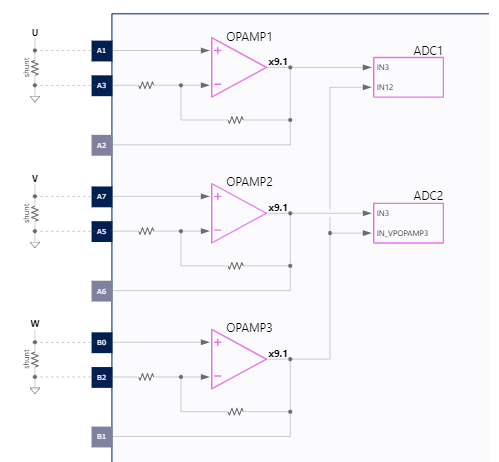

I want to understand the current sensing that is done in B-G431B-ESC1 kit.
I do not understand the purpose of IN_VOPAMP3 connected to ADC2
The opamp3 can be connected to ADC1 and ADC2 as shown in the figure? The software configuration of opamp3
hopamp3.Init.InternalOutput = ENABLE;
whereas for opamp1 and 2 is
hopamp1.Init.InternalOutput = DISABLE;
and the code for ADC2 is
sConfigInjected.InjectedChannel = ADC_CHANNEL_3;
sConfigInjected.InjectedRank = ADC_INJECTED_RANK_1;
sConfigInjected.InjectedChannel = ADC_CHANNEL_VOPAMP3_ADC2;
sConfigInjected.InjectedRank = ADC_INJECTED_RANK_2;
Please advise on the above configuration.

Hello @Community member,
The purpose of using IN_VPOPAMP3 is to allow the sampling of the two phases simultaneously by the two ADCs.
We sample 2 phases among 3. Thanks to IN_VPOPAMP3 the phase W can be sampled by both ADC1 and ADC2.
phases U,V are sampled by ADC1(IN3),ADC2(IN3)
phases UW are sampled by ADC1(IN3),ADC2(IN_VPOPAMP3)
phases VW are sampled by ADC2(IN3),ADC1(IN12)
The OPAMP3 InternalOutput is managed dynamically by the FW. For the initialization by cubeMX we have to enable it in order to be able to configure the sampling delay of the ADC2 channel (IN_VPOPAMP3) .
I hope it is clear now.
Regards
Cedric

Sorry it is enabled now after OPAMP3 setting.
2023-04-26 2:44 AM
Exactly, the channel is enabled only if the internal connection between OPAMP and ADC is enabled.
Be aware that this connection is exclusive, if the OPAMP is internally connected, then it is disconnected from the pin. In our software, we change this connection dynamically at PWM rate.
