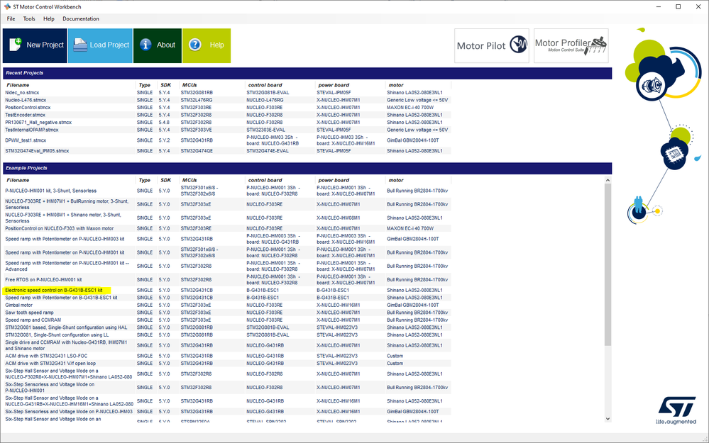

Dear Cedric,
please allow me one more question,
When you say "select the ESC-G4 board from the example list" which application or web site do you have in mind?
I did create some code from the MotorControl Workbench 5.Y.4 and 6.0.0, but none of them do have somthing like "new project from example". And the generated code does not contain an esc.c file.
And although the STM32CubeMX 6.6.1 does have an example list, it knows nothing about a ESC-G4 (B-G431-ESC1) board. So which application should I look for? Thank you!
Best Regards
Thomas
2022-09-26 6:33 AM
I have in mind MC Workbench 5.Y.4. look at the attached screen shot.
The example is not ported yet on version 6.
Regards
Cedric
