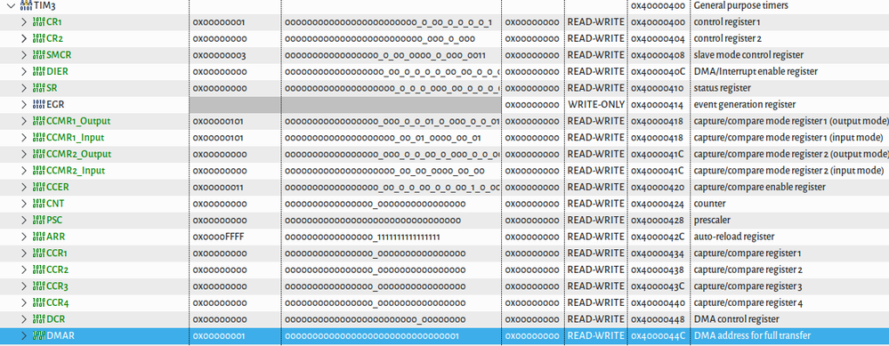

Viewing at the registers, I noticed that the SR update bit was set, so I reset it before timer start. No difference. Here is the full register dump:
2020-06-30 11:23 AM
Looks good.
