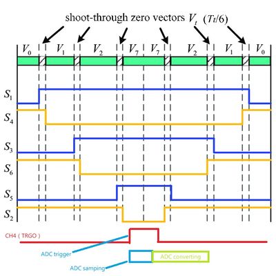

The MCU i'm using is STM32G431CBT6Right now i ended with ADC trigger as TIM1_TRGO and using the TIM1 CH4 as the ADC trigger also the i have set the TIM1_CR2.MMS to OC4REF
since timer1 is set to center alignment, the TRGO/CH4 will also be in the center
Although the ADC is triggered on rising edge, ADC sampling takes time,by adjusting the pulse width of TRGO and the adc sampling time, it can sample close to the center
Also your idea might be good setting the TIM1_CCR4 to the same value as TIM1_ARR, so that there's a match at the center of the pulse i'll try that
