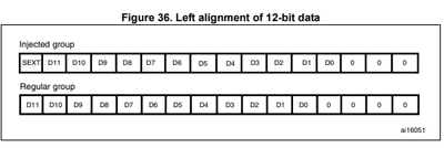

From the release manual (RM0368 Rev 5) , page 221, you can read this :
The converted data value from the injected group of channels is decreased by the userdefined offset written in the ADC_JOFRx registers so the result can be a negative value.
The SEXT bit represents the extended sign value.
For channels in a regular group, no offset is subtracted so only twelve bits are significant
With the following table :
As the FW consider the data left aligned, we must multiply the read value by 2 to align D11 with bit 15.
