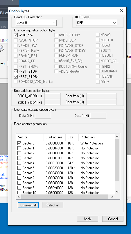

I switched to a windows machine and attached the screenshot, stlink utility reads0x0FFF which is completely different. Trying to figure out what's happening.
________________ Attachments : screenshot.png : https://st--c.eu10.content.force.com/sfc/dist/version/download/?oid=00Db0000000YtG6&ids=0680X000006Hxr5&d=%2Fa%2F0X0000000b1a%2Fasuw397ZASS6PSCvqtTiFok3LxI0AVQSeaE0tuEm0Gc&asPdf=false2018-03-22 9:28 AM
So I changed the option bytes using stlink utility to the following (details in screenshot).
I am still able to write to sector 0 using dfu. Any idea ?

So is this the readout value of the option bytes?
And does the DFU actually overwrite the 1st sector? AN3156 in footnote to Table 4. DFU bootloader commands , for write when write protection enabled, says:
This operation is allowed but not effective: the bootloader does not return an error but the operation is not
executed since the sectors are write-protected. This applies only to the Flash memory. It does not apply tothe RAM memory or the option byte area.I know nothing of DFU, but the quote above says that principially it *is* possible to remove the write protection by writing to the options, so the PC side program may do this before performing the write itself (as the STLink Utility does, albeit it does warn about it too).
