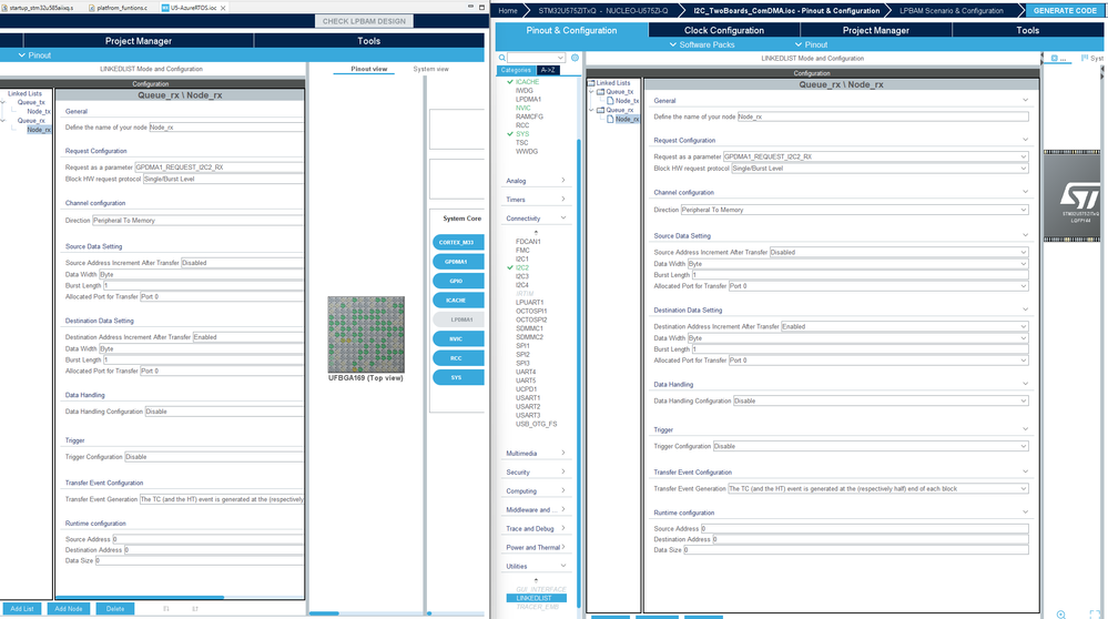

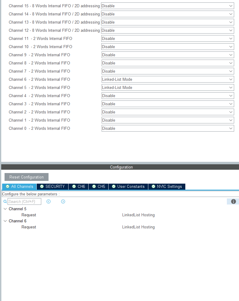

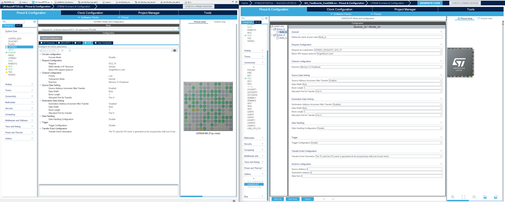

Thanks for your help, I appreciate you taking the time. I have had a look through the U575 example, good thinking, I had not considerd having a look at example from a different U5. The first thing I notice is the use of linked-lists, is this needed for I2C? I had a skim read through AN5593 (quite daunting but I guess you only take what you need) and it does not seam to say if linked lists are strictly needed for I2C. Apart from the use of linked lists, my settings I have been using are identical (see Bellow). I did take note of the call to __HAL_LINKDMA in the example you provided and thought that might be my problem but I found that call in the HAL_I2C_MspInit function of my code.
I have also just tried using linked lists and I have not had any success there either, see my modifed test code and MX configs bellow.

Hello @WrenchInTheWorks
The use of linked lists in DMA is not strictly required for I2C communication. Instead, it depends on the specific requirements and configuration of your DMA and I2C operations.
To use the DMA in standard mode with I2C, please refer to the article "How to configure the GPDMA". In this article, we describe the necessary steps to configure GPDMA in standard mode for UART transmission. You can adapt it to your I2C application.
You can also look at the example Projects/NUCLEO-H743ZI/Examples/I2C/I2C_TwoBoards_ComDMA, which uses DMA in standard mode for I2C communication.
If your issue didn't get solved, please consider sharing your entire project with us so we can support you more effectively.

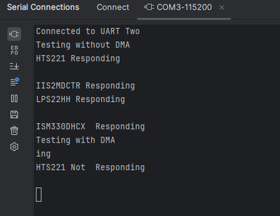

2025-02-08 10:48 PM
Hello @Saket_Om,
Unfortunately no success. I'm testing with a very simple program now, works without DMA but the DMA functions don't work. I will include ther ZIP of the project bellow and a screenshot of my output. I'm unsure why the termnal is displaying extra lines but thats not the main problem here. Thanks again for your help!
