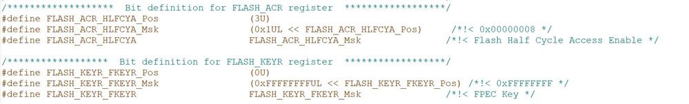

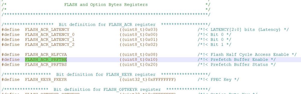

Why on STM32CUBEF1 code version 1.8.1 bit FLASH_ACR_PRFTBE is not define? while on previous version on 3.5.0 it was defined.
STiwa.1
Associate
STM32CUBEF1_1.8.1 has no bit description of FLASH_ACR_PRFTBE0693W000003RYZGQA4.jpg

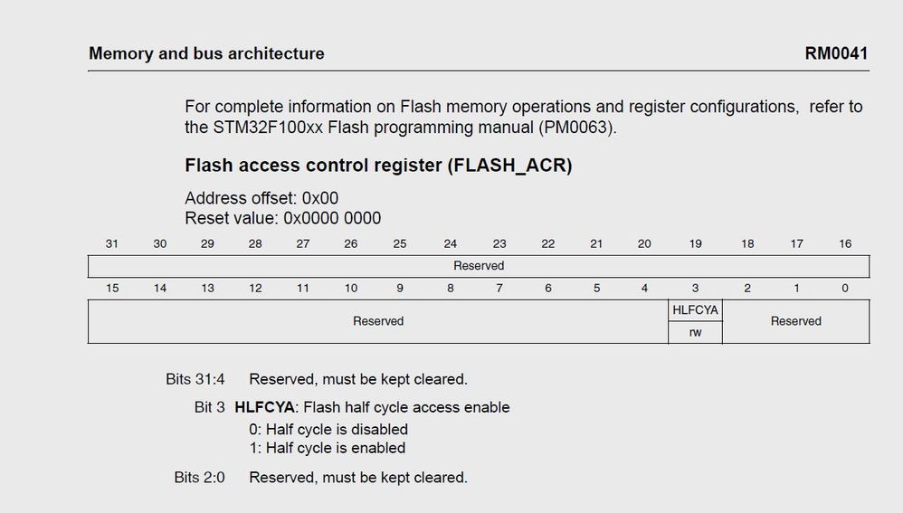

I read manual and got to know only flash half cycle access can be control rest bits are reserved.0693W000003Re0bQAC.jpg
