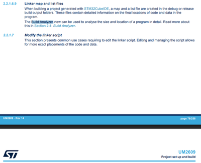

But, for any project, the way to see the memory usage is to look at the Map file...
Plus, in CubeIDE, there's the Build Analyser
https://www.st.com/resource/en/user_manual/dm00629856.pdf#page=76

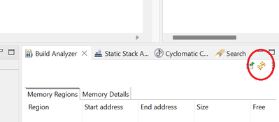

Thanks for the link to the simulator, I'm sure that may come in handy in the future. In response to your initial point, it is outside the scope of the question but there is a good reason for it. I just want to solve the question posted. Regarding the build analyser, for some reason despite having both a .elf and .map (now I've compiled and reduced the heap size) it's still blank.
2025-04-03 4:34 AM
@CDyer.1 wrote:Regarding the build analyser, for some reason despite having both a .elf and .map (now I've compiled and reduced the heap size) it's still blank.
You can refresh the build analyzer:
2025-04-03 4:36 AM
oh my god, I assumed it refreshed per compilation. I'm an ***. Thanks!
2025-04-03 4:48 AM
@CDyer.1 wrote:oh my god, I assumed it refreshed per compilation. I'm an ***. Thanks!
No. That's a reasonable assumption. It's just not user friendly. Sometimes it refreshes, sometimes it doesn't. Worse is when the analyzer window is not empty, but outdated and you scratch your head why the memory sizes don't change...
