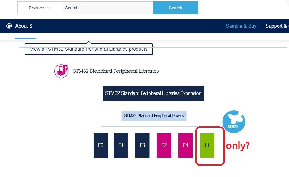

i done make working file with STM32F031F6(STM32F0xx_StdPeriph_Driver) at the first time...
and now, we will change to STM32L031F6(STM32L0xx_StdPeriph_Driver) ..
but doesn't have in https://www.st.com/en/embedded-software/stm32-standard-peripheral-libraries.html
so i try to with STM32CubeMx...some function has working well but have trouble with TIM2 and I2C1... i cann't find problem.... lol
so just i want try with STM32L031F6(STM32L0xx_StdPeriph_Driver)..that's is simple
ask to who???

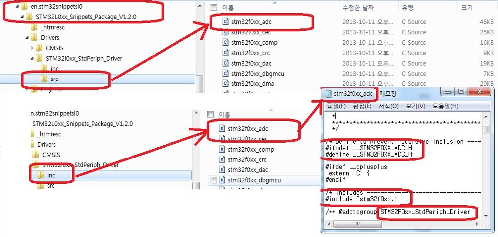

but, when i use to snippet code(with en.stm32snippetsl0.zip), so many not matched for STM32L0.
source has refer to STM32F0xx many times
like down picture
and i was tried to LL drivers available in the STM32Cube package before..
i failed also..
