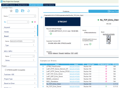

I also checked if DHCP works on the NUCLEO-H723ZG board. The Ethernet-related examples supported by MX on the NUCLEO-H723ZG board include TCP echo client and TCP echo server, and both examples use DHCP. In these examples, only the message "The network cable is connected." is displayed, and the assigned IP is not displayed. When measuring the TX signal through the scope, no signal is output.
Please help.
