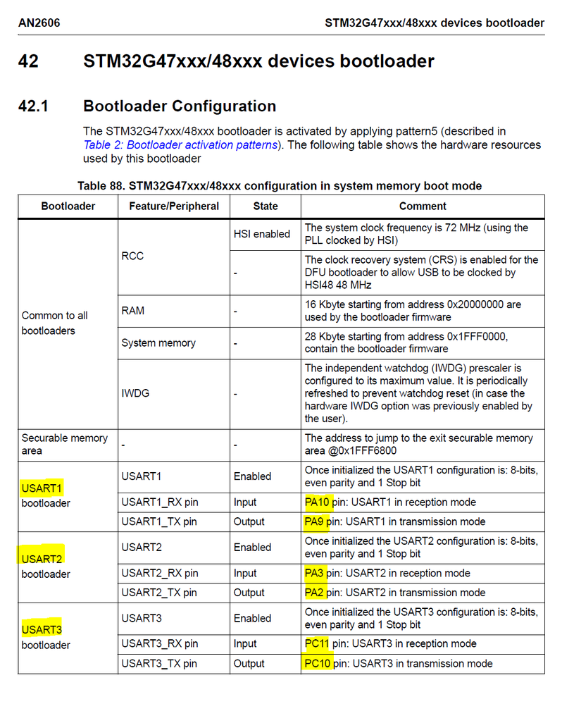

USART1, USART2 and USART3 are available. The details are in AN2606.

What does App Note AN2606 say for your part?
