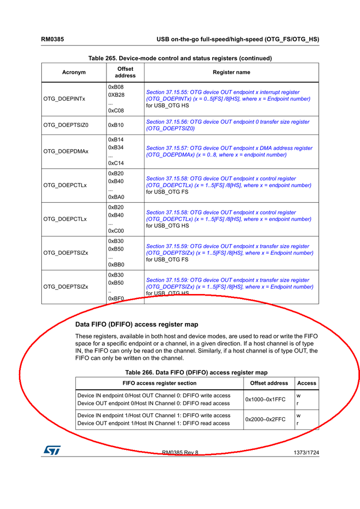

I have not found anything on USBx_DFIFO on these manuals. In that matter, I have not found anything on DFIFO either. The only place I was able to find any information was with OpenAI.
On the basis that OpenAI had to have gotten this information from somewhere, I was wondering where I could find documentation on USBx_DFIFO is.

Hello @OIp.1 ,
Please refer to RM0385 and precisely 37.11 USB data FIFOs Section and 37.14 OTG_FS/OTG_HS control and status registers Section.

USBx_DFIFO() is obviously either a function or a macro. Now many IDEs will point you to its definition, but it's enough to use a textual search on the libraries you are using, in your case obviously CubeF7.
#define USBx_DFIFO(i) *(__IO uint32_t *)(USBx_BASE + USB_OTG_FIFO_BASE + ((i) * USB_OTG_FIFO_SIZE))of which USBx_BASE is a variable defined at the beginning of given function and assigned pointer (i.e. address of) OTG module through function parameters; USB_OTG_FIFO_BASE and USB_OTG_FIFO_SIZE are constant macros defined in the MSIS-mandated device header, both as 0x1000.
In other words, this macro returns address which is offset from address of the given OTG module by (0x1000 + 0x1000 * number-of-endpoint). And that is the address of FIFO for given endpoint:
While Kaouthar gave you pointers to subchapters, you ought to read the entire OTG chapter in RM for further understanding of FIFO's role in this module. USB is complex, and the OTG module is very comples. FIFO usage is quite tricky and the steps given in the usage subchapter have to be obeyed. Note, that FIFO is word-aligned, word-accessed-only; the entire 0x1000 area (each word in it) in fact is one single "window" register through which data are pushed/pulled to/from FIFO; and that every register which is used to determine FIFO's assigned size is in words.
