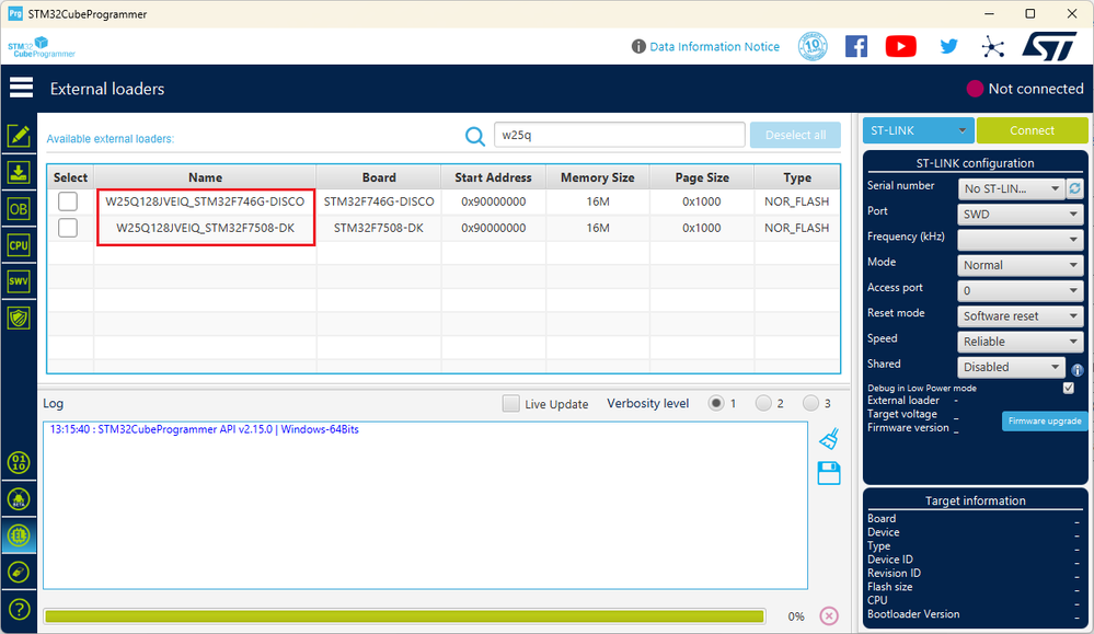

I found that the external loader of "STM32CubeProgrammer" includes "W25Q128JVEIQ_STM32F746G-DISCO.stldr" and "W25Q128JVEIQ_STM32F7508-DK.stldr", but please tell me where I can download the source code of these two external loaders? Because I want to modify it according to the pins of the STM32 development board and add it to my project.

I'm not sure ST has published their source for these. Other examples can be found on Github.
What STM32 family are you using,and what are your QSPI pin assignments?

You can refer to this github repository contains the Flashloaders source code of external memories embedded in STM32F7 HW boards.

These don't include the Winbond models on some of the DK

Thanks, while there is no ready-made source code to modify, I will use MX25L512G as a reference to design my code
