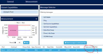

2023-11-04 4:27 AM
2023-11-05 2:27 AM
There are no info. for "Selected SRC PDO" , your can see every thing is ok now. Could you please tell me where misss a trace print code? I will correct.
Thanks,
Matt
2023-11-06 2:25 AM
@Lmatt.11 If you start UCPD monitor after the capability messages are sent, you will not have all details.
Could you share the .cpd file ?
Have you solved your orientation problem ? If yes, can you share for other forum visitors please ?

2023-11-06 5:02 AM
Hello Matt,
Your comment is fair because selected PDO is no more displayed since last STM32CubeMonitor-UCPD version (under update).
You can find all useful information for the Power Delivery negotiation on trace as shown on left trace.

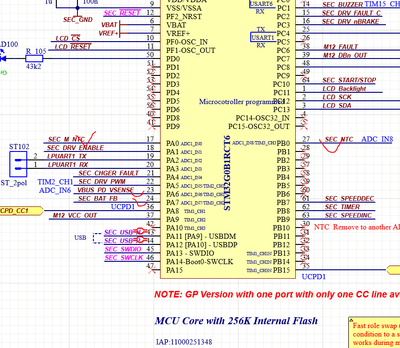

2023-11-08 8:39 PM
@MROUV.1 ,
Good morning,
I did some debugging works checked, I found that when I configured multi-channel ADC. The other channels cannot work normally, but if only one channel for VUBS and comment out the others, the orientations will be worked fine.
What's the reason, we need 5 ADC channels for we need monitor other analog signals.
But it seems the PD stack core did some limits for the ADC.
