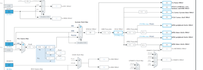

i am just guessing: might be, what CubeMx shows, when you start a project (and set nothing)
HSI driving core and bus...otherwise no start code/your code could start ever.

2023-11-20 10:13 AM
MCU just continues clocking from HSI or MSI clock that it start with by default, and all the AHB / APB are basically at DIV1 settings.
On H7 most will be running at 64 MHz HSI across all buses.
