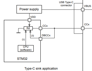

first question to answer : have you set some pull down (Rd) resistors on the UCPD block ?
In type C, you have to configure pull up or pull down resistors to indicate which will be your power role.
Have a look at the wiki, or the AN5225 (page 24).
If you just need 5V, no more, no negociation, you just have to set fixed pull down resistors.
This can be achieved either using the dead battery pins (DB), or by driving the UCPD block.
Only this way a power delivery source will provide VBUS.
