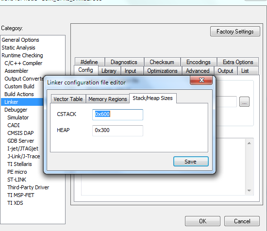

Our embedded application keep crashing
VListinsertendafter some time of operations. FreeRTOS code is generated using CubeMx. What could be the possible issue ?FreeRTOS details
FreeRTOS 8.2 with heap 4 , Systick timer
osThreadDef(Task1, StartTask1, osPriorityRealtime, 0, 256);
osThreadDef(Task2, StartTask2, osPriorityHigh, 0, 196);osThreadDef(Task3,StartTask3, osPriorityRealtime, 0, 256);osThreadDef(Task4, StartTask4, osPriorityAboveNormal, 0, 196);http://www.st.com/en/microcontrollers/stm32f303cc.html
256 Kbytes of Flash memory40 Kbytes of SRAMWhat should be the ideal CSTACK and HEAP size for the this kind of applications ?
Custom size cstack and Heap
Can anyone guide us in the right direction on how to find the right size of CSTACK and HEAP for the application ?
#stm32f3 #freertos #stack #heap2018-02-05 6:27 AM
The STACK in this context is probably just what's need to start all the other tasks, and those allocate theirs from the HEAP.
..You, as a developer, need some conception of what demands your code generates, the call depth of your routines, the auto/local variable usages, and the expectations for malloc/free dynamic allocation of resources.
