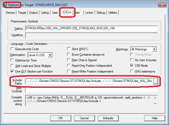

I tried to copy the folder STM32Cube/cubeF4... so when i change something it doesn’t make any changes in the original folder, so then I compiled , the error was in main.c (#include “main.h�?) (no such file or directory).

Should be under the project options tabs for whatever tools you are using, perhaps review docs related to "Include Paths", it is a standard C compiler concept.
2019-07-08 12:01 PM
So either you haven't copied all files the project consists of, or you don't have your Include Paths set up correctly.
Paths can be relative in certain tools, so a directory copy needs to maintain the same depth.
For Keil you can simple duplicate/clone a would directory, and sub-directories, at the same level

The part about configuring the tools so they can search the appropriate file paths to find the files making up the project..
