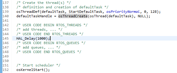

Now, in main function, I add "HAL_Delay(1000)" after creation of the default task with "osThreadCreate" function:
When I debug this code, the "SysTick_Handler" is never launching.
And the code hangs in the "HAL_Delay" function where "HAL_GetTick()" function returns always 0.

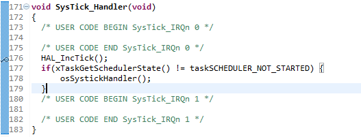

I add this check in "SysTick_Handler":
BUT the problem persists because the "SysTick_Handler" was never launched.

A ok. For me it works but for you, firstly, remove this:
" if (xTaskGetSchedulerState() != taskSCHEDULER_NOT_STARTED)"
beacause it's already done in the osSystickHandler.
The HAL tick and the Os tick are completly independant. Normally, you have to use the TIM 1 as timer for the HAL tick. Is it done ?

But, if I call HAL_Delay before osThreadCreate, SysTick_Handler is always launched.
In the following code SysTick_Handler is never called:
And in the following code SysTick handler is always called (no problem with this code):
What is the difference ?

I don't know exactly what happen in the freeRTOS source code, but I think osThreadCreate will change the Systick.
You juste have to read the code of freeRtos te be sure.

I just ran into this issue and I thought I would leave an answer which explains what is happening for anyone else experiencing this issue and how to avoid it. FreeRTOS raises the NVIC base priority as soon as any FreeRTOS function (such as osThreadCreate) is called. This disables most interrupts, including SysTick. It is only after the scheduler starts that the the NVIC priority is lowered to normal, re-enabling interrupts.
It is best to do all of the FreeRTOS/CMSIS-OS initialization in one block, doing nothing else within that block. Everything else should be done either before the first FreeRTOS call or within a FreeRTOS thread.
