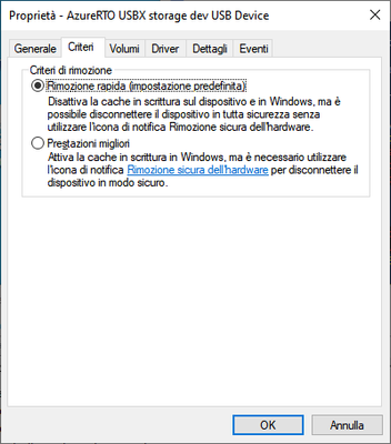

With Windows 11
Thanks

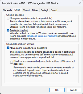

2024-10-10 6:14 AM
Windows 11 storage driver is set by default in QUICK REMOVAL. In this mode usbx doesn't work.
If i set policy in BETTER PERFORMANCE, usbx work fine.
Can you help me how to setting automatically this policy? Do i need a driver or something?
