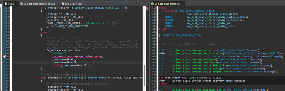

I am on an H562 and trying to rd/wr a file on a USB memory stick using the mass storage controller.
I am trying to understand what to do about this block when I am running in standalone mode. I started from an example code which is in RTOS mode but I want use the standalone mode.

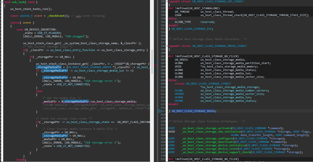

When I tried to implement something meaningful in UX_DEVICE_INSERTION status, it turns out that the expression
_mediaPtr = &_storageMediaPtr->ux_host_class_storage_media;fails to compile because 'UX_HOST_CLASS_STORAGE_MEDIA' has no member named 'ux_host_class_storage_media'.
I think the problem is in this definiton:
but I need to use FILEX.

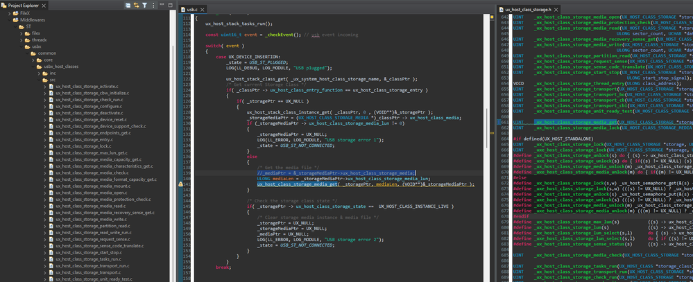

Than I tried the method 2 using the function 'ux_host_class_storage_media_get' but it is not present in the folder Middlewares/ST/usbx/common/usbx_host_classes/src
Which of the two methods should I use? How can I skip the problems? Do I have to define something different?

I have the same problem with the function '_ux_host_class_storage_driver_entry'
It is unreachable due to the #define UX_HOST_CLASS_STORAGE_NO_FILEX

Thank you for the support, the fx_system_initialize() is called during the initialization.
I can declare the protottype in usb.h, but what about the implementation? This function will be called somewhere and I don't have the code. I'm thinking about some #define problem from the .ioc or an incorrect usage of the API provided.
2025-11-18 6:05 AM - edited 2025-11-18 6:08 AM
already declared in ux_host_class_storage_driver_entry.c
I think that the logic host storage class in standalone mode allow users to use file system in applicative side (filex, fatfs, .... ) in this case you need to customize ux_host_class_storage_driver
2025-11-18 8:12 AM
Hi @Capocc, @Mohamed_AYED
AFAIK, USB MSC standalone for host operations is still not supported because of this dependency with FileX in threadX context.
