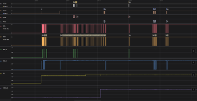

Investigation over I2C bus communication show that the issue is caused by CC lines debouncing process, which lasts for 120ms and blocks DPM communication with other ports:

Resulting diagram:
Now all ports are managed in parallel.
I also replaced HAL_Delay with osDelay in TCPC driver to not block other tasks.
