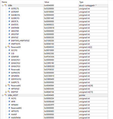

2. An external 8MHz oscillator is used in our application. As to the USB speed, I mean the value "To USB(MHz)" in STM32CubeMX software's Clock Configuration. Should it be 48MHz or 12MHz for FS mode?
3. I am checking the value of register section 62.14.20, but I am not quite sure the correct value (bit value) in each register. Can you let me know the value or bit value I need to check. The register values in my application are shown below.
