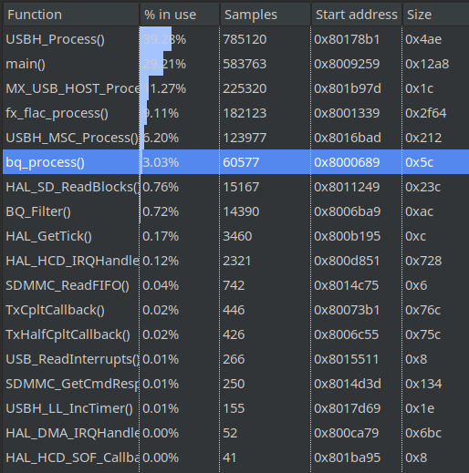

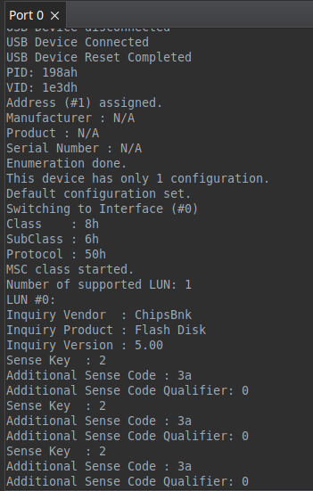

i installed SWV , to see more info, this is coming, when debug level on usb is set :
obviously usb stick is enumerated, can read size and directory, but when read data (16KB) it hang up in some usb BOT loop or USB_busy state.

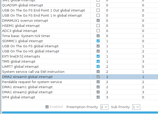

ok, found problem:
the usb file read is first called in main (worked always), then from DMA callback;
so usb INT needs to have higher priority than this DMA INT;
i set it on same priority , but higher sub prio.
didnt work....
until i set now the DMA INT to next lower priority (1.3 -> 2.1 ) - now ok again.

Take a note that ST USB stack's APIs cannot be called from non-interrupt context or from interrupts of different priorities without providing an appropriate protection. It's designed by incompetent fools...
Better invest your time in TinyUSB!
