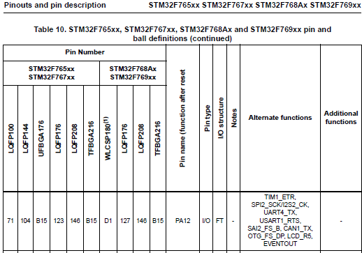

On our target hardware I have only DATA-/+ available, so I have connected the DATA pins from the usb cable to the PA11 and PA12 pins and connected GND. Then configured the app to use
USB_OTG_FS with no VBUS sensing:

Coming from a STM32L4 world - PA1 looked a little unusual....Same in your part world.
PA12 maybe - Hopefully you just made a typo here

Sorry, PA1 was a typo. It's PA11 and PA12 as in the code.
