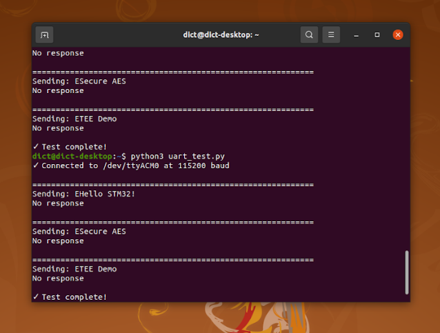

I am working with TEE, and my goal is to send plaintext from the reComputer to the STM32L5 so that it can be encrypted on the device. However, when I send data, I do not receive any response.
I have tried using both the USB port and ST-Link, but the result is the same. I can see the ST-Link device on the reComputer, but when I use USB CDC, it is not recognized.

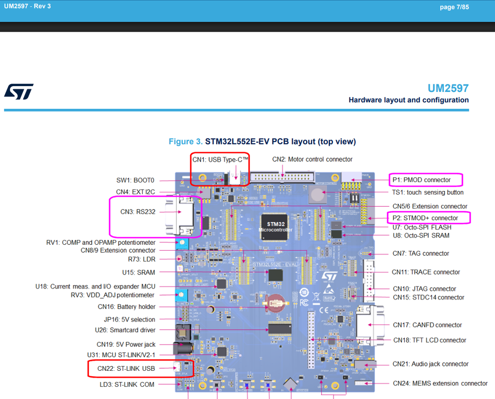

The connection (CN22) of STLINK over a virtual comport (windows) offers a kind of "UART protocol over USB".
If you need to use the USB you need to use CN1 connector (USB FS).

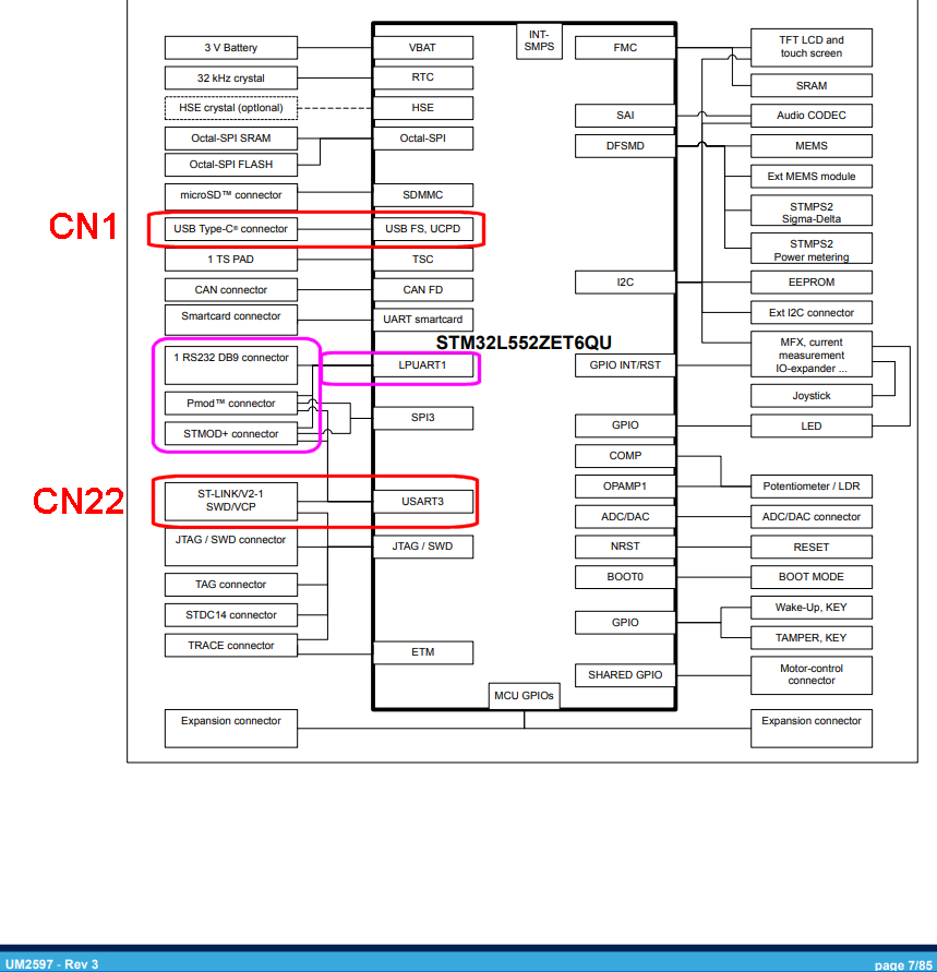

As @mƎALLEm said, the ST-Link provides a Virtual COM Port (VCP); for native USB, you would use CN1.
For the VCP, you just need to use the STM32L5 UART on whichever of the STM32L5's pins is connected to the VCP - see the board's User Manual for details.
For native USB, you would have to make a complete USB device implementation.
CubeMX will give you access to examples...
PS:
The STM32L552E-EV also has an RS232 port, so you could use a USB-to-RS232 adaptor;
There are also logic-level UART signals available on the PMOD and STMOD+ connectors, so you could use a UART-to-USB adaptor (of the appropriate voltage) there.
These will also give you a VCP.
2026-01-21 3:19 AM
From the User Manual:

Currently, I am using the CN1 port for USB FS, but I am still facing an issue. When I connect the board to the reComputer J4012, the USB cable is detected physically, but no USB device (CDC) appears on the reComputer side. So when I try to write commands, I cannot see any USB interface to communicate with.
Could you please advise what additional configuration is required on the STM32L552 (CubeMX / firmware side) so that the CN1 USB FS is enumerated correctly as a CDC device on the host?
Thank you for your support.

I also tried using the ST-Link VCP (CN22) connection.
With ST-Link, the reComputer can detect it correctly, but I cannot send any data to stm32l5 and receive a response. However, when I use the CN1 USB FS port, although the cable is connected, the reComputer does not enumerate any USB CDC device from the STM32L5, so I cannot send commands or data.
