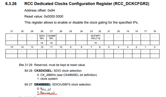

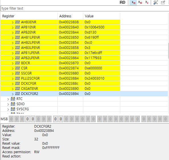

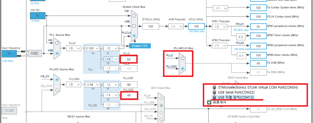

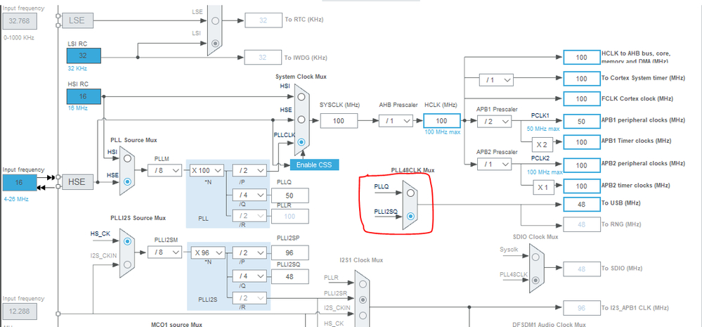

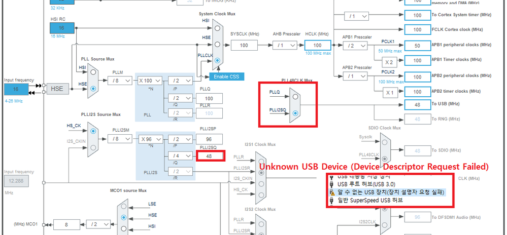

Hello!
FW version
0693W00000Y9Z9RQAV.pngUSB Device_Only mode. (Virtual Port Com)
Select PLLI2SQ clock.
Unknown USB Device (Device Descriptor Request Failed)
Not Setting PLL48CLK Mux ?​ PLLQ 50Mhz?

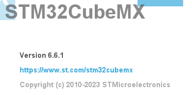

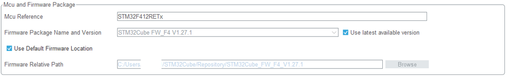

Hi.
STM32CubeMX Version is 6.6.10693W00000Y9oY7QAJ.pngAttach ioc file.

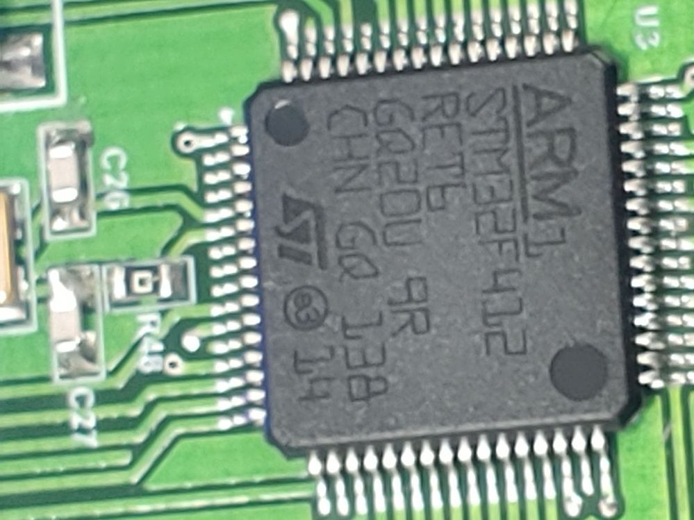

Hi.
Can you confirm that the chip is genuine?
