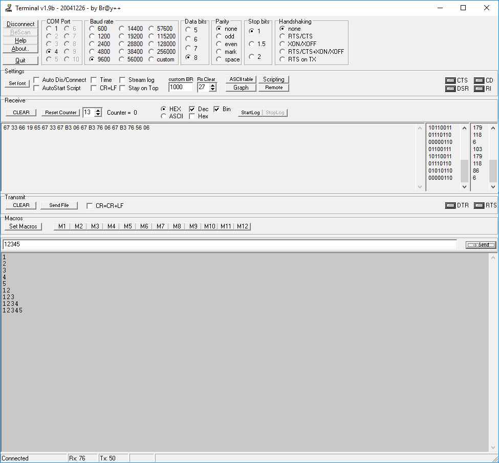

I'm trying to use USART Interface with STM32F3Discovery board.
I'm coding using HAL libraries.
Transmitting data from board proceeds with no errors.
The problem is when I transmit data to board from computer something goes wrong.
There are examples of transfers:
In case of single number messages I have next table:
1 - 0x67
2 - 0x33
3 - 0x66
4 - 0x19
5 - 0x65
In case of multiple number messages:
12 - 0x67, 0x33
123 - 0x67, 0xB3, 0x06
1234 - 0x67, 0xB3, 0x76, 0x06
12345 - 0x67, 0xB3, 0x76, 0x56, 0x06
What do you think the problem could be?
Thank you for your answers!
