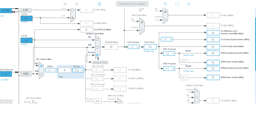

I'm trying to transmit a bitmap via USART. The bitmap transmits correctly in HAL. My project is register-based, written from scratch. The issue is that my USART has a speed synchronization problem—meaning:
When my C# terminal is set to 57600 BAUD, it reads one byte correctly, but an additional zero byte is received and written to the buffer index.
At equal speeds (115200 BAUD) for both the MCU and the terminal, it incorrectly reads the bitmap byte, and still receives an extra empty byte in the buffer.
I can't figure out what's wrong. I suspect it might be a misconfigured clock system. My board is Nucleo-F303RE (STM32F3xE). I’d appreciate your help!

2025-04-22 5:02 PM
@TDK Yes, You are right. Everythings work corretly when I change for 18 Mhz. I was just corious becasue IOC shows me in clock configuration that I have 36Mhz, but when I left not divided prescaler or divided by 2 I still have to set it for 18Mhz... It have pushed me to that I might had something wrong in my code ...
