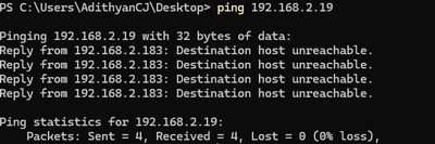

Hello @mƎALLEm I am using LWIP stack , not using RTOS . I tried to assign a static IP to my board ( not DHCP ) and tried to ping from my pc . I was unable to ping .I am using NUCLEO-H723Zg development board.

Hello @ASEHST Pc and board are on the same network and subnet. Also the static ip , subnet mask and gateway is correctly set in the code . Ethernet callback is coming and netlink is setup , physical layer connection is also established , still unable to ping

Hello @CJ007 ,
Have you changed the IP address in your code accordingly by default it is set to 192.168.1.15 in lwip.c file.in fact, this example is working and has been tested multiple times.
