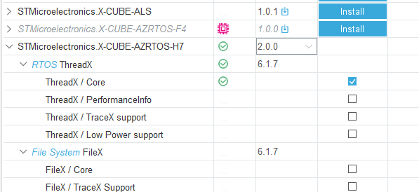

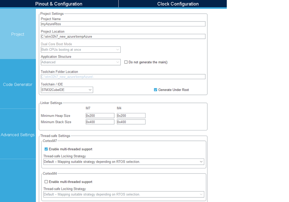

I am trying to create anew project for STM32H745 discovery board.
I included middleware "STMicroelectronix-X-CUBE-AZRTOS-H7 -> ThreadX / Core" option.
But when I generate the code, there is no middleware code in the project.
Please see attached snapshots for more details

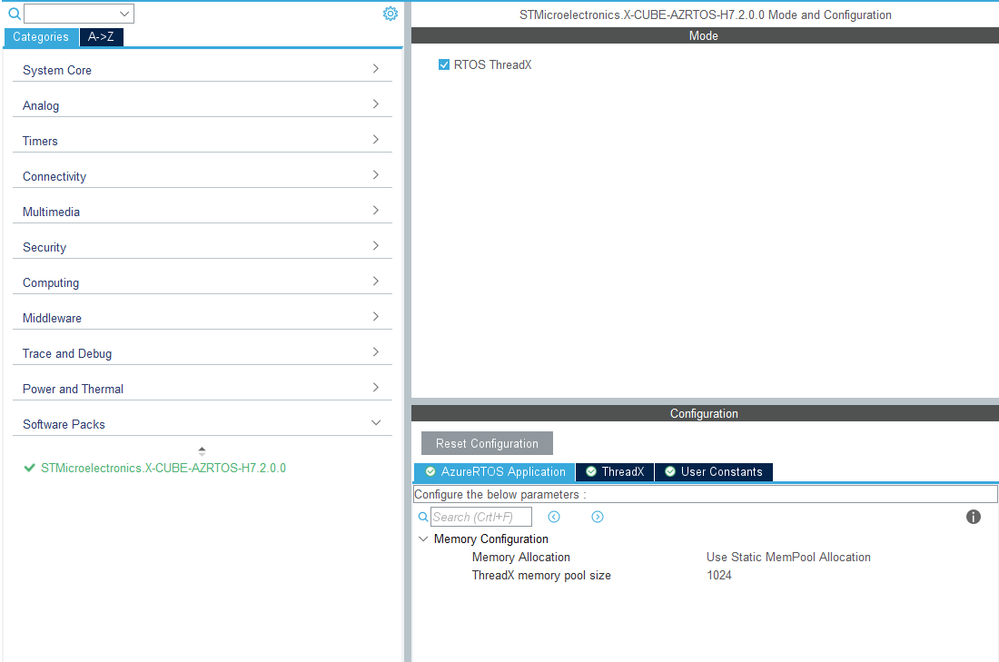

Hello @Community member
Probably, you have not configured the ThreadX. Make sure that you configure your ThreadX.
I hope you find this answer helpful. Do not hesitate in case you have other questions.

2021-10-21 6:01 AM
The option did the fix.
