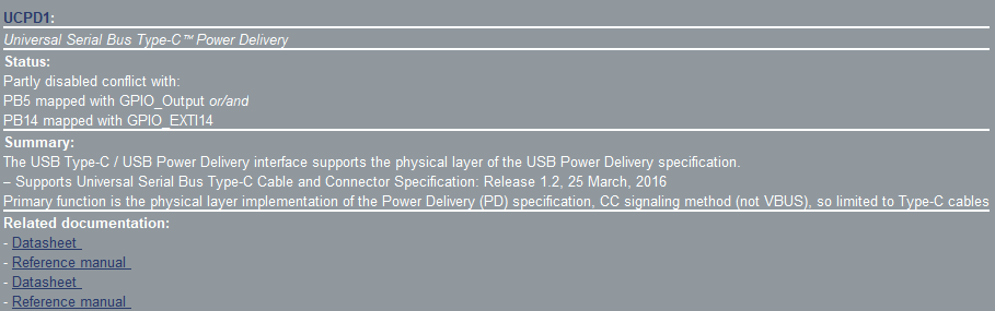

I noticed that a few pins would be set already when I started the project. After configuring all the same parts in the .ioc file, I did end up with some status warnings on ADC1 and UCPD1 peripherals.

STM32CubeMonitor-UCPD program is used through VCP link available with ST-Link connector (USB).
Does not care about this warning... it is not used for our purpose.

For the Debug trace, it shows a similar Status warning of "Partly disabled conflict with:..." since the PA15 pin is required for DEBUG_JTDI but is being used by UCPD1_CC1. There appear to be no alternate pins for DEBUG_JTDI or UCPD1_CC1 to be populated on. Also, does it matter what debug mode should I choose for the trace to show up in the STM32CubeMonitor-UCPD program?
