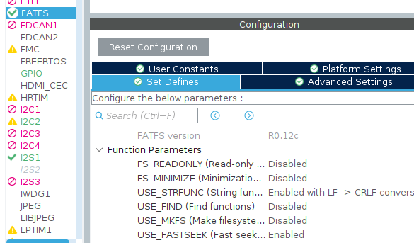

2023-02-10 1:12 AM
so there is no "write" at all. because at "close" buffers flushed and real write to disc. without close it can be just in buffers, no real write at all.
so check, there is no write protection and in Cube check , write is enabled.
(here my setting, just mkfs disabled.)

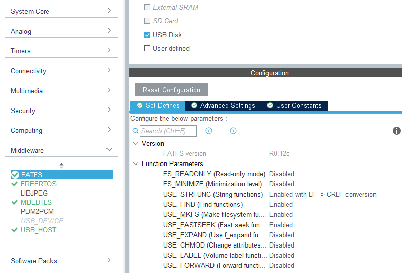

2023-02-10 6:28 AM
Ok, I checked and there doesn´t seem to be any write protection. You say it could be reading the write buffer vector?
