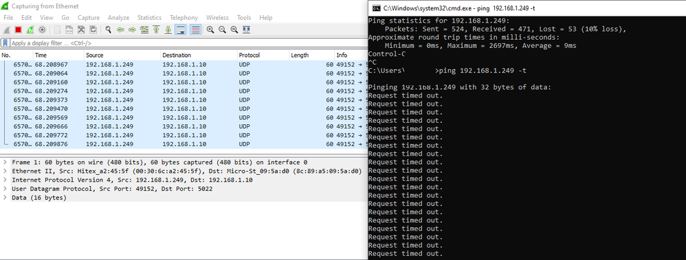

After some seconds/minutes my MCU get rested( I receive correct data before and after resting). It makes me crazy. I can't understand why?
I call SetSCK() when after 300us socket is failed(Socket<0). what is my mistake?
In addition in some situations while I am receiving the correct data, my mcu doesn't respond to ping command.(I have set the IP at Net_Config_ETH file).
